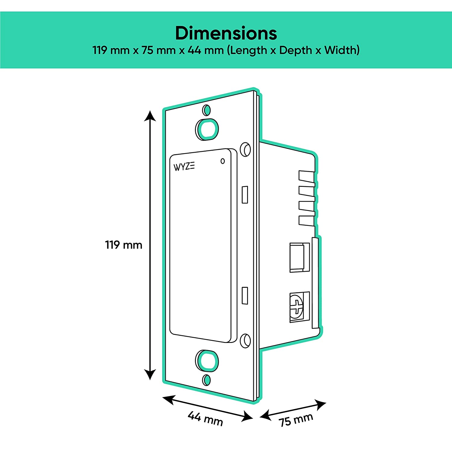

Dimensions
119 mm x 75 mm x 44 mm (Length x Depth x Width)
